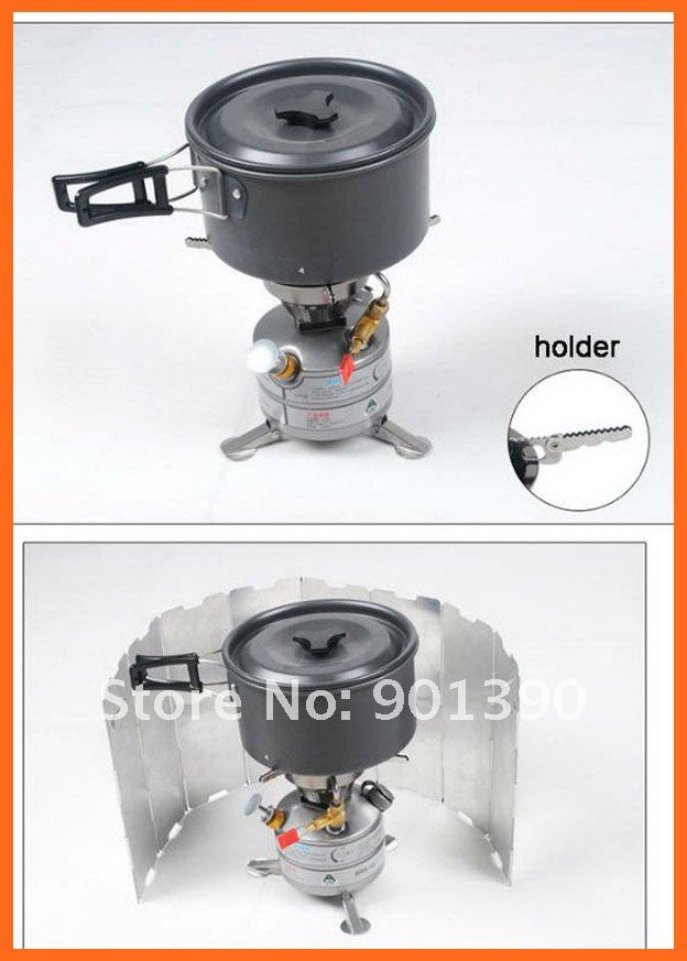

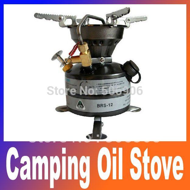

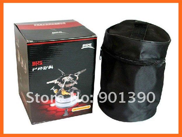

มาช่วยเติมให้เต็ม สำหรับผู้ที่ชอบท่องเที่ยวแบบแคมปิ้ง
เตาปิ๊กนิกใช้เชื้อเพลิงได้หลายชนิด แบบชิ้นเดียว กับแบบแยกชื้น
ราคา $58.88
Product Description
I. Lighting Instruction:
1.      Shut the valve and screw the oil cap tight.Pump gas into the gas tank with the lever until you can feel the pressure,but never overpressured.
2.      Turn the valve lever anticlockwisely to emit a bit of gas and shut it again.
3.      Use open flame to ignite the burner for preheating(about 30 seconds for gasoline).
4.      When a whirr is heard,open the valve steadily to the firepower needed.
5.      After closing the valve,when the flame is small enough, just blow it out in order to keep the stove clean.
II. ATTENTION:
1. Fill it outdoors please.
2. More than 5 metres away from any kind of fire when you fill.
3. Never loosen the oil cap while the stove body is still hot or a fire is not out.
4. Stove must be level while filling to avoid oil leakage.
5. Kindly recommend clean gasoline 93# and above.
6. Never use it in big sunlight or other high-temperature environment.
7. If any oil leak is found,instantly stop usage.
8. Never use as a space heater.
III. WARNING:
1.      Only can you add fuel or disconnect when the flame is out after being shut down!
2.      Keep away from anything combustible,including gas tank,oil bottle!
3.      If use it with a windproofer, keep the flame away from the windproofer more than 25cm, in case of too hot oil tank!
4.      Never use in an unventilated or enclosed area!
5.      Keep away from children!

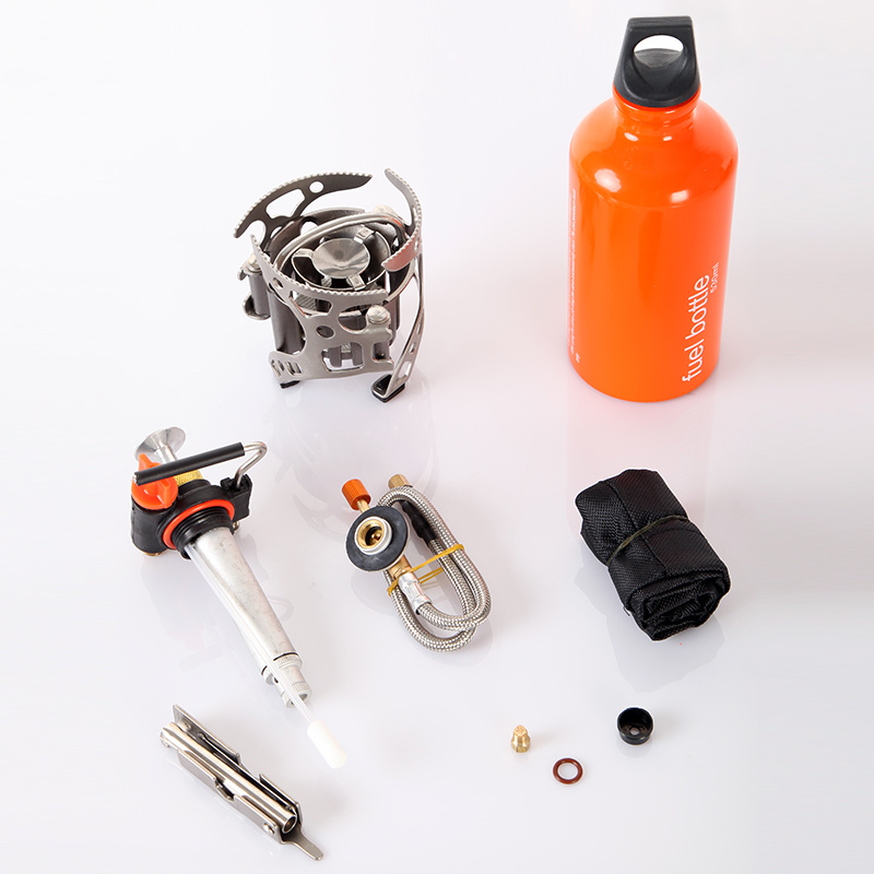

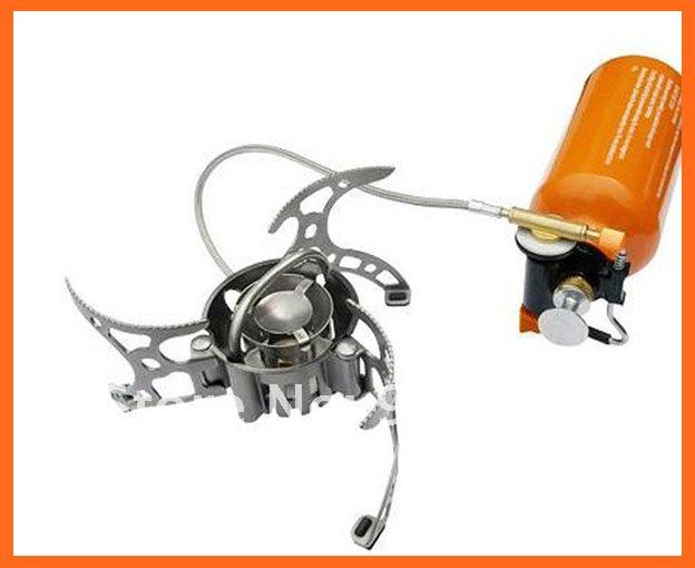

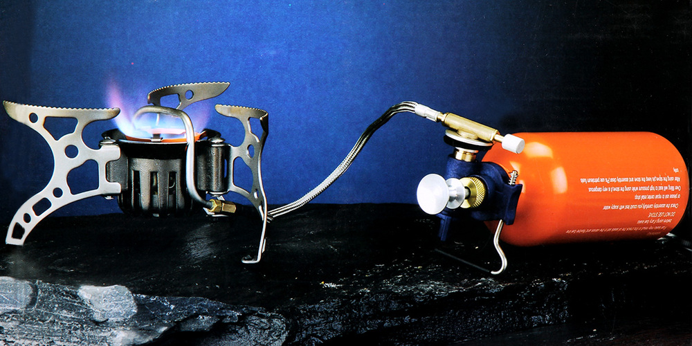

Re: ทำไฟไว้แคมปิ้งครับ
« ตอบกลับ #17 เมื่อ: 3 มกราคม 2013, 15:32:38 »
แบบแยกถังออกจากเตา
ราคา $50.35 ไม่มีกระเป๋าใส่ ถ้าแบบมีกระเป๋าจะแพง
Quickview:
Features:
Collapsible bracket for convenient use.
Super bearing capacity bracket can bear vertical pressure within 80kg.
Better pre-heating effect due to unique design of pre-heating device (only 30 seconds).
Strong firepower: it only takes 3 minutes to boil 1L water (change with weather, fuel, and cooking ware accordingly).
Gas Pump has been built-in wear resistant device, which makes the inside cup leather more durable and has larger gas supply.
Material of high strength aluminum alloy and stainless steel.
Very easy to ignite the stove with the match or the lighter.
Multi-function tool set enables easy and convenient installation and maintenance.
All the seal rings have the characteristics of wear-resisting, aging resistance, oil resistance, high temperature resistance, good recovery rate, etc.
Specifications:
Color of the fuel bottle: Orange
Ignition: Lighter or match ignition
Hose length: Approx. 27cm / 10.63in
Stove open size: Approx. 18 * 14 * 9cm / 7.09 * 5.51 * 3.54in
Package size: 27 * 20.5 * 9cm / 10.63 * 8.07 * 3.54in
Weight: 575g / 1.27lb
Package weight: 835g / 1.84lb
Package includes:
1 * Gas Stove
1 * Fuel Bottle
1 * Hose
1 * Pump
1 * Pipe wrench
1 * Bag
